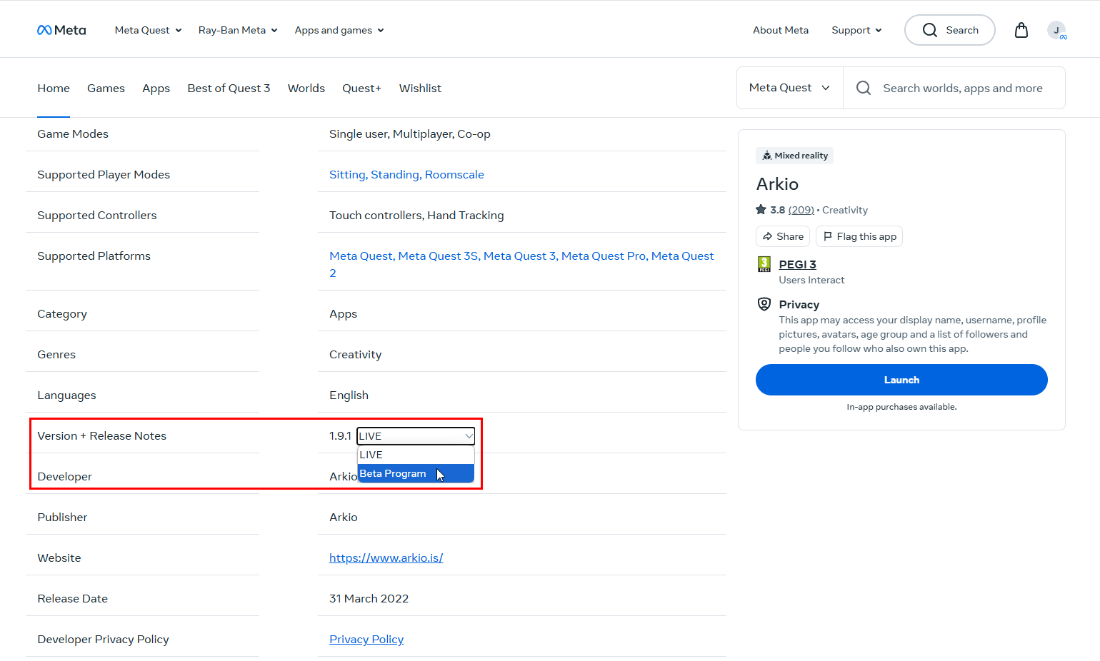

On Quest, you first sign up for the Beta release channel using the above link. After joining the beta you can switch between the 1.9 release version of Arkio and the beta by going to app Settings (click … on the Arkio app from the library) and switch to a different release channel. You can also switch between release channels from the Arkio store page or on your Meta Horizon phone app by clicking on the version number
After switching versions the Arkio app will be auto-updated next time you start the app. You can also force an update/downgrade by visiting the Arkio store page by clicking “see details” and “install”

To switch back to the live release on Quest you can go to your library app settings on Quest (or visit the store on your phone) and switch back to the “Live” version. You might have to visit the Arkio store page on Quest to trigger the downgrade/upgrade.

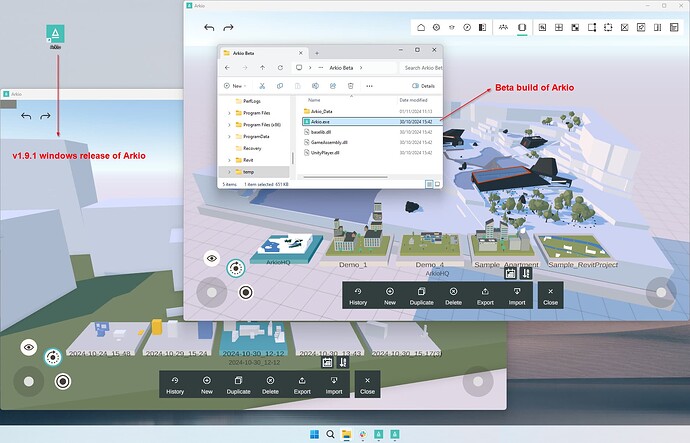

For the PC release, you can start the old release version of Arkio that should be still installed on your system at C:\Program Files (x86)\Arkio instead of running the Beta build from the default installation path at C:\Program Files (x86)\ArkioBeta. You can run both the 1.9 release build and the 2.0 Beta build at the same time in Windows in case you need to do some troubleshooting.
